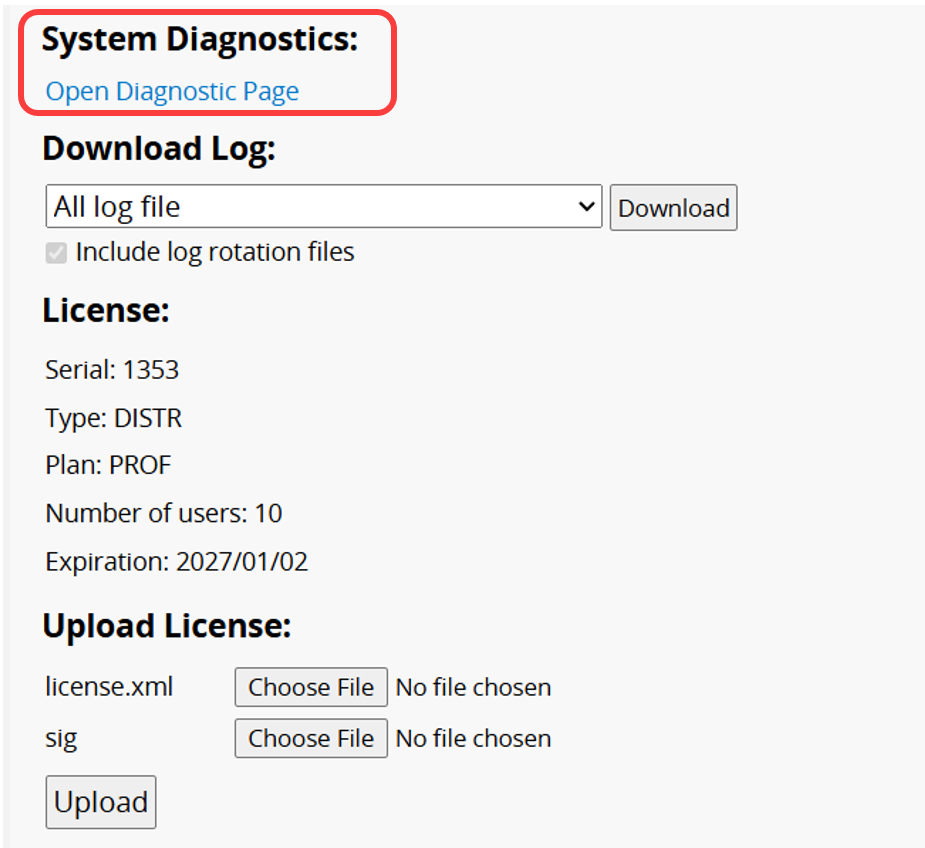

    System Diagnostics
    You can go to Account Setup > On-Premises Config. In the System Diagnostics section, click Open Diagnostic Page. On this page, you can quickly review the status of each feature, identify which are operating normally and which may have issues, and provide the diagnostic information to Ragic support for further troubleshooting.
