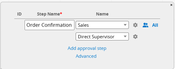

Click Add approval step to add the Approval process.
Set the Step Name, which is mandatory, for an approval step such as "Purchasing Manager" or "Project Manager".
Selecting the Approver
In the Name field, specify the User for a fixed approver, or choose a user group where an approver can be selected from when submitting for approval.
You can choose approvers from the Organizational menu with the following options:
1. Direct Supervisor sends the request to the user's direct supervisor.
2. Supervisor of Supervisor directs the request to the user's supervisor's supervisor.
3. Supervisor of Previous Approver routes the request to the previous approver's supervisor.
Note: To enable the approval functionality for direct supervisors and their supervisors, you will need to use the Direct Supervisor field in the system User sheet. If this field is not available in your sheet, please contact Ragic support to update it.

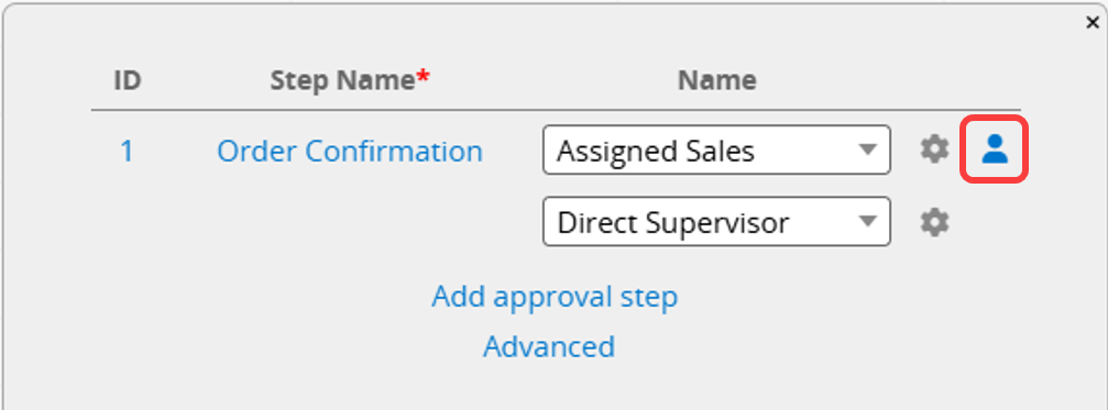

You can also select approvers from the Select User or Select Group field.
For example, you can send an approval request to the "Reviewing Officer" (the designated approver in charge) of this record instead of selecting someone from the "Procurement group" as an approver.
If you want to set non-users (such as clients and suppliers) as request approvers, you can choose the "E-mail" field. The approval request will then be sent to the designated email address, and it can be directly approved from the email.
You may also rearrange the order of approval using drag and drop.

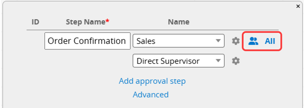

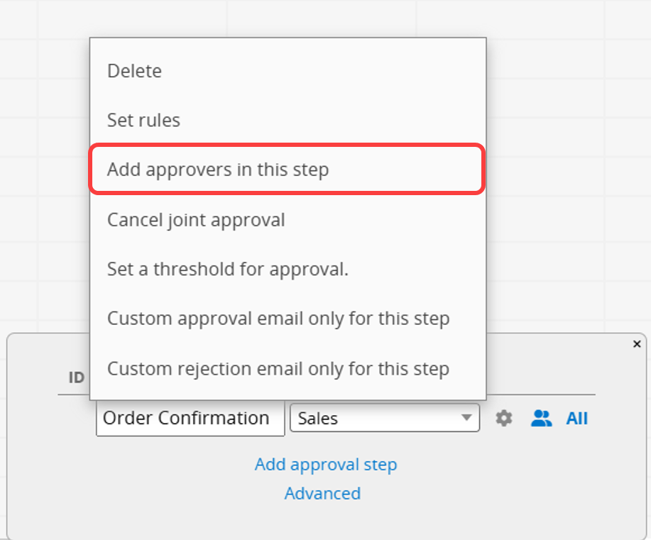

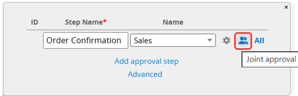

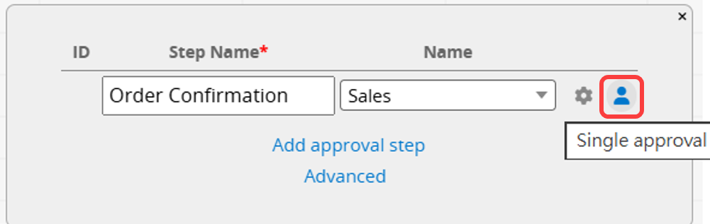

Adding Approvers in This Step

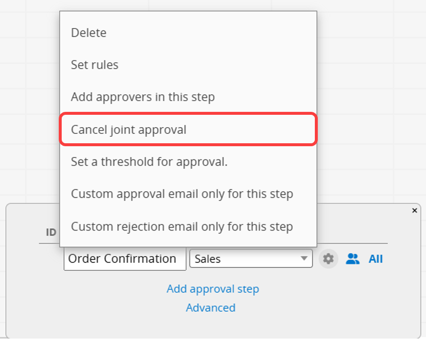

By clicking on the "gear" icon located just on the right of the approver selection menu, you can add approvers in this step. By doing this, all the approvers in this step must approve this sheet to proceed to the next approval step.

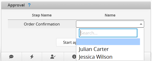

If you want users to determine the number of approvers at the same step, you can set up a Select User field and enable Multiple selection. Then, when configuring the approval process, select this field twice. This ensures that all the users chosen in this field must complete the approval step to proceed to the next one.

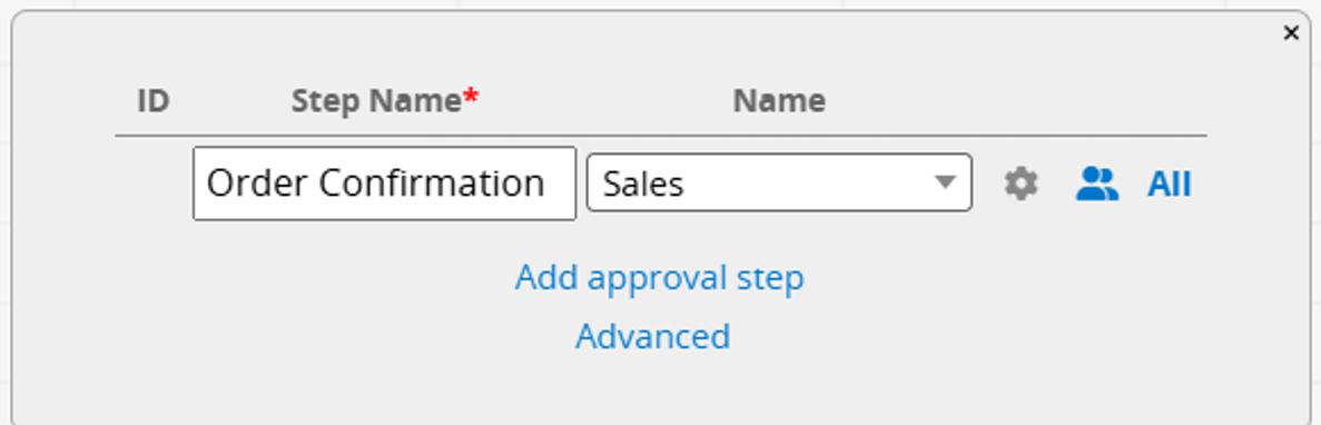

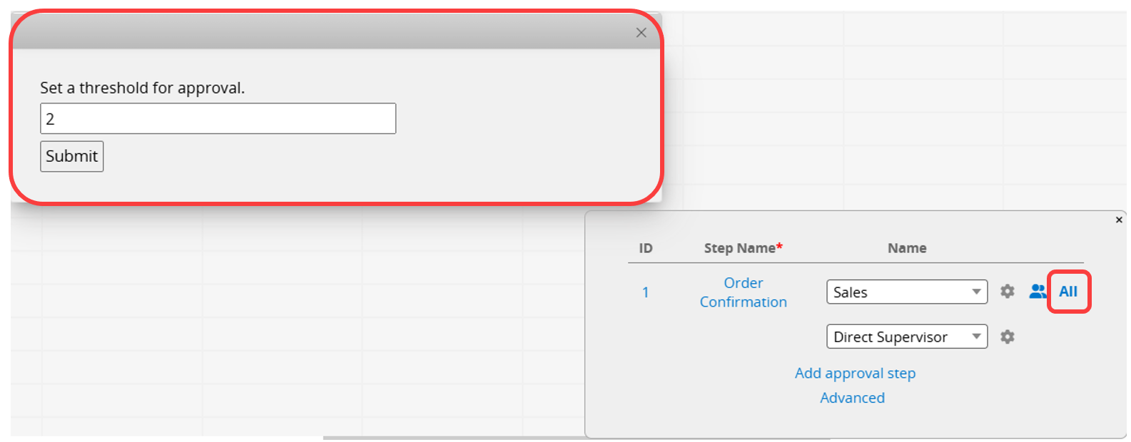

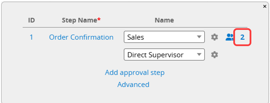

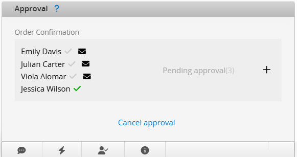

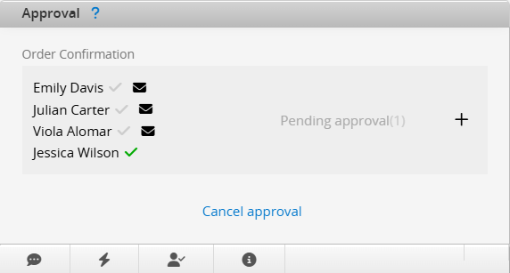

Setting a Threshold for Approval
After adding approvers in a step, you can also Set a threshold for approval. For example, if there are three approvers on the first step of a record and you set its threshold for approval as 2, this record will proceed to the next step after two users in the first step have approved it.
If you would like all members of one or more groups to approve a record, you would need to set at least two approvers in an approval step, which you can then set its threshold for approval.
For example, if the HR user group has four users and you would like all four users to approve before proceeding to the next step, you can set the HR user group or anyone in the HR user group in the approval step. After that, you’ll be able to see the threshold for approval, which you can then set as 4.
