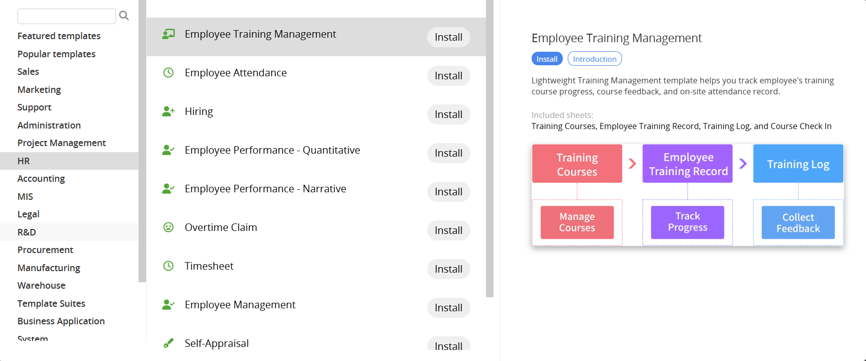

    If you don’t have a Ragic account, click here to sign up and install the "Employee Training Management" template. This entire process is free, and we will not charge you without your consent.
    If you are already a Ragic user, you can find the "Employee Training Management" template under the "HR" category in Install Templates and click "Install" to download it.
